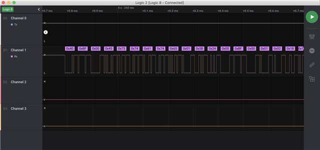

I've configured UART2 on the nRF9160 to connect to a nRF52840. The nRF52840 generates a payload and sends it over to the nRF91. The payload size during testing was 65 bytes. The problem with all of this? Using the CONFIG_UART_INTERRUPT_DRIVEN code, the UART peripheral is able to receive the first 8 bytes correctly. Then there's an additional 4 bytes of bogus data followed by the start of the next payload. (Same first 8 bytes) I'm running UART @ 250k BAUD.
Everything matches up with the transmitting device signal wise.

It seems like there may be a potential error condition or that the interrupt is not getting called fast enough to process the data?

    This seems to be an issue related to the UART implementation unless Im missing something huge here. If I simply print out the bytes from the ISR, it prints the first 8 and then stops. Seems like there's an internal 8 byte buffer. Anything after that 8 bytes gets dropped as far as I can tell.
