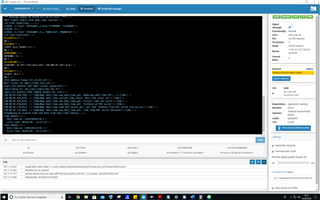

nrf_log module doesnt work now.. I am working on it, mean while can you please check this out..
this was the output when i used int datatype
EDIT : I am getting the same result using the character array pointer as well
below is the code i used for character array

Hi Tobjorn,
Thanks, this is a perfect example to work on now.
I just had to ask a question which was related to time synchronization.
I see that the real time differs by 2 hrs : 14:13 to 16:13 . Just wanted to know if this could be fixed by tinkering with the values. This would be the perfect time stamp for my usage :).
Adeel.
sorry , I meant 16:12 to 18:12. I see a gap of 2 hrs. Just needed a heads up on how to calibrate it :).
I understand now that the time I am getting is UTC from the NTP server.
How could I convert it to get a time in CEST zone ?
Adeel.
