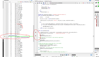

       when i try to compile the code with release mode the application is trying to execute the location area where the application code doesn't exit because of which the board is restarting every time.
    It is entering into the location 0x3EE40 where it couldn't find the valid code. Also when i try to set the breakpoints it is not allowing to set. it is showing ! mark inside the breakpoints and not stopping there. could you please figure out it.

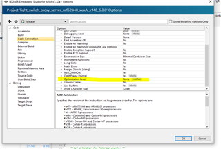

      Additional to above information the code which is compiled in release mode work if we set the optimization level to none or debug as shown below snippet.
    I am not sure why the compiler doesn't generate the proper executable when the optimization level is set to Optimization for Size and running in the release mode.
    Please let us how we can use the optimization level setting in release mode.

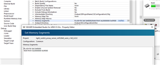

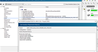

     Is there any problem with the memory configuration we are doing while using the option release mode, because the same code works fine in release mode when we set the optimization level to either None or DEBUG.
    Could you pleases suggest the memory configuration is correct or not in the below snippet
    We are using S140 Softdevice along with the bootloder.
    Memory Segment
    I am also attaching the Flash_placement.xml in the attachment. please have a looks
