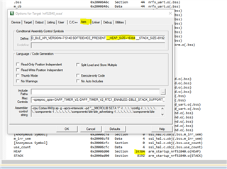

Memory Allocation and Heap Size nRF52840
Hi! I'm working with an nRF52840 SOC using SDK 17 and Keil. When I try to allocate memory to a structure of size 8388 bytes, malloc always returns 0. I've set __HEAP_SIZE=16384 so it shouldn't be the problem. I've also tried and configured the memory manager like this: MEMORY_MANAGER_MEDIUM_BLOCK_SIZE 256 times MEMORY_MANAGER_MEDIUM_BLOCK_COUNT 64 is 16384 bytes, which should be enough. However, nrf_malloc also returns 0. What am I doing wrong?
