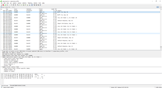

Hello I'm working with Zigbee Dimmable Bulb example. Testing environment is as followed:
nRF52840DK
SmartThings Gateway
SmartThings iOS app.
After changing the Zigbee channel to 14 in the example everything works great.
The problem occurred when I was trying to add the electrical measurement cluster to the above example.
After that, the device is not discoverable in the SmartThings App.
Can anyone more experienced in Zigbee could take a look on the attached code ? I can't figure out what am I doing wrong.
Best Regards,
Jakub

    yes I want to add the electrical measurement cluster to the light bulb cluster.
    I have updated the zb_ha_dimmable_light.h with:
    - incrementing the ZB_HA_DIMMABLE_LIGHT_IN_CLUSTER_NUM by 1.
    - adding ZB_ZCL_ELECTRICAL_MEASUREMENT_REPORT_ATTR_COUNT to the ZB_HA_DIMMABLE_LIGHT_REPORT_ATTR_COUNT
    - adding el_meas_attr_list to the ZB_HA_DECLARE_DIMMABLE_LIGHT_CLUSTER_LIST
    - adding ZB_ZCL_CLUSTER_ID_ELECTRICAL_MEASUREMENT to the ZB_ZCL_DECLARE_HA_DIMMABLE_LIGHT_SIMPLE_DESC
    After those changes the application started but I cannot notice any electrical measurement related data in the sniffer:
    As You can see in the code, the electrical measurement should be sent with on/off.
    The updated main.c and zb_ha_dimmable_light.h you can se in the attached code.

  • Some debug logs:
    <info> app: zcl_device_cb id 0
    <info> app: Set ON/OFF value: 1
    <info> zboss:  DE AD 12 02 E5 28 B3 00|.....(..
    <info> zboss:  01 00 00 00 DE AD 0E 02|........
    <info> zboss:  04 00 00 00 DE AD 12 02|........
    <info> zboss:  06 00 00 00 01 00 00 00|........
    <info> app: Set DC POWER value: 1
    <info> zboss:  DE AD 12 02 E5 28 B5 00|.....(..
    <info> zboss:  01 00 00 00 DE AD 12 02|........
    <info> zboss:  E5 28 B6 00 1A 08 75 01|.(....u.
    <info> app: Set level value: 255
    <info> zboss:  DE AD 12 02 E5 28 B7 00|.....(..
    <info> zboss:  1A 08 60 01 08 00 00 00|..`.....
    <info> zboss:  E5 28 B8 00 1A 08 75 01|.(....u.
    <info> zboss:  DE AD 12 02 E5 28 B9 00|.....(..
    <info> app: zcl_device_cb status: 0
    <info> zboss:  DE AD 12 02 E5 28 BB 00|.....(..
    <info> zboss:  E5 28 BC 00 1A 08 75 01|.(....u.
  • Hello Jakub,
    updating the attribute value triggers sending frames only if there is an active reporting configuration for that specific attribute.
    Please verify that the hub has configured both the binding and the reporting configuration for the DCPOWER attribute.
    BR,
    Tomchy
