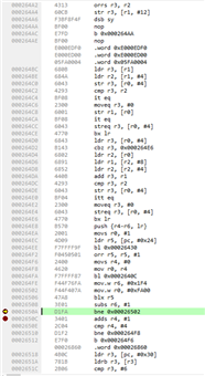

  • start_app()                                                  // here is my problem !
I have tested all my functions, I have no issues before trying to restart on app, the application is well written (checked with Segger J-FLASH tool).
To restart my device on the new app I firstly used nrf_bootloader_app_start() but nothing happened, my program crashed during the reset.
So, after some research on the Nordic DevZone I found this post.
I followed the first answer (I also tested the second one with no success).

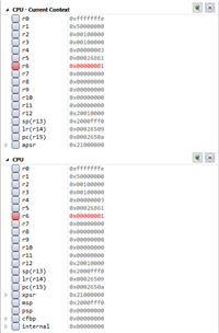

With the first solution I can see my LEDs up but only one time after my device reboot on bootloader  (I see "Starting Bootloader" on Segger embedded studio debug terminal).
I'm really not familiar with the assembly language so it could be normal, or maybe I miss something really simple with the different registers.
  1. Is there any change to do in MBR or Softdevice or somewhere else when I update my app?
  2. Is the found solution viable? What did I miss to stay on my application?
