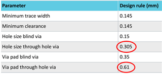

regarding the Nordic guidelines for aQFN, it recommends to use 0.305/0.61 for through hole via.

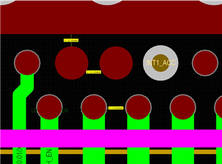

We are using 0.2/0.4 to avoid soldering bridge and non find any issue after several times production.
we still need the help from Nordic, do you have any concern or recommend for it?
