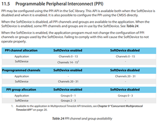

Hi, we have a product that we want to update with new fuctionality, We use latest S110 for NRF51822 and would like to have more than 2 ppi groups useable.
In what scenarios will the softdevice use ppi group 2 and 3? can we use them ourself given that we dont use the features in S110 that uses those groups?
The same goes for the PPI channels 14 and 15
