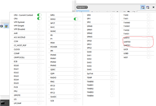

    Can you set a breakpoint after you enable the UART, and read out the register 0x40002544 and 0x40002534? These should point to the UART TX and RX buffer. In Segger Embedded Studio, you should be able to see them directly in the IDE if you click "Groups" under the "Registers"  window. Depending on what UART you are using, select that one:

    So the underlying issue here is that you have some issues with the UART, right?
    Yes I had, but today, idk why it works back. I hope it is due to flashing problem. But I am still interested about RAM content, and particularly my previous question. Also, I have seen that the NUS service use the MTU,what is it exactly ?
