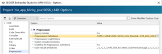

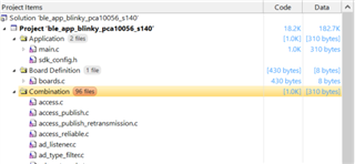

    You don't necessarily need to copy the source files anywhere. "Including the source files" refers to adding the source files into your project. When you open the project go into the left pane(Project explorer), right-click on the Project/a folder then press "Add New File...".
    In addition to adding the sorce files you need to include paths to your include files. Do the following:
    1. Right-click on your project, press "Options.."
    2. In the upper left corner in the drop-down box, change from "Debug"/"Release" to "Common"
    3. Under "Code", press "Preprocessor"
    4. Choose "User Include Directories" and add the path here
    Assuming you are using SES.

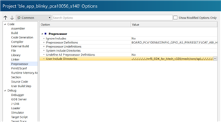

  • Hi  and thanks for replying me with detailed info. Now I have another error.
    To sum up what I have done so far: from this tutorial, I followed the all 3 steps like this:
    Including nRF5 SDK for Mesh functionality in an nRF5 SDK example
    1. Include the following source files from nRF5 SDK for Mesh in the nRF5 SDK example's project file - done. I created a folder in SES like you explained, like this:
    2. Add the following folders to the project include path of the nRF5 SDK example - done. I added all 15 mentioned folder paths  in the "User Include Directories" like this:
    ../../../../../../../nrf5_SDK_for_Mesh_v320/mesh/core/api
    ../../../../../../../nrf5_SDK_for_Mesh_v320/mesh/core/include and so on for all 15 folders.
    3. Add the following preprocessor symbols to the project file of the nRF5 SDK example - done. I added it similarly:

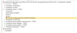

    However, when building the project, I get the error: nrf_mesh_config_app.h: No such file or directory.
    I notice that it is used in the context:
    #ifdef CONFIG_APP_IN_CORE
    #include "nrf_mesh_config_app.h"
    Could you please help me debug this issue? Should I just comment it? I mention that I do not even find this .h file in my Mesh folder. However, I can just copy it from here.

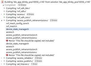

  • Hi .
    A short update: I decided to copy that file from the internet and now that error is gone. However. I get the following:
    #error "This file should be copied, not included."
    What does this refer to? I do not understand what "copy" and "include" mean in this context. Should I just copy the content? If yes, where?
    Thanks in advance.
    From the documentation Integrating Mesh into nRF5 SDK examples:
    • If you are adding you own mesh functionality rather than working from an existing mesh example, you also need to add the file nrf_mesh_config_app.h. Copy it from the examples/templates folder in mesh stack repository into your project folder, and remove #error message at the top of the file. Make other appropriate changes to the file content, like adjusting ACCESS_ELEMENT_COUNT and ACCESS_MODEL_COUNT to the required number of elements and models.
    Can you try copy from the template instead and remove #error message at the top of the fil? Does it make any difference? Also, go through the "Optional changes" in the document.
