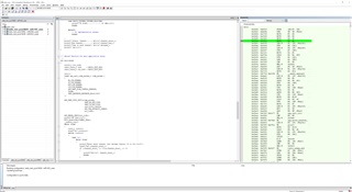

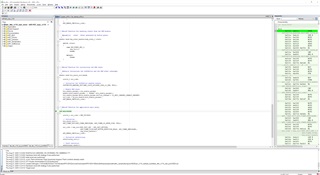

  • Hi Jay,
    I downloaded SDK version 12.3 and reviewed the attachments as suggested. I am doing FCC testing therefore I am looking at examples\peripheral\radio_test. However, I am having a start up issue with radio_test. On the other hand, I was able to flash, start and break at main() with examples\dtm\dtm_serialization ok.
    I set the same MCU to nRF51822-CEAA to both example projects. Both IAR projects have Debugger->Run into main checked. However, I can't get radio_test break into main(). I uploaded  my screen shots for both projects.
    Please let me know what I should check.
    Dennis
  • I found the issue. In radio_test, the IAR project compiler->Output->Generate debug information is not enable. Thanks,
