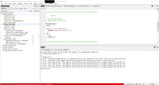

Students download Segger Embedded Studio and compile the "Hello World" project from the 'nRF Samples' Solutions.

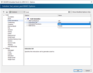

When I do this on my PC, everything compiles OK, but some of my students get an error message during the '"link" stage.   The message seems to indicate problems with Thumb mode instructions.
Everything has been left in the "default" mode when the "Build" is started.
Is there a setting that I missed?

    I have never seen this myself, but I would assume the default configuration should be the same for any SES install. It would be interesting to know if you get the same problem if you try to build an example from the nRF5 SDK? For instance <SDK 17>\examples\peripheral\blinky ? If not, then it looks like something went wrong when generating the example project.
    As this question is about Segger Embedded Studio isolated (not using SDK code), it may be a good idea to ask Segger.
