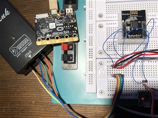

Dear Nordic Semiconductor support team.
I tried to make my nrf51822 DK to talk to Micro:bit by using Gazell library. ( from nRF5_SDK_12.3.0_d7731ad\examples\proprietary_rf\gzll\gzll_ack_payload\host)
I've read your support using micro:bit with nrf52832 by RADIO in the past as follows.
https://devzone.nordicsemi.com/f/nordic-q-a/41770/how-can-i-make-nrf52832-talk-to-microbit-by-radio-gazell
So I rewrite a simple function base on your code, hoping to receive wireless data from Microbit. And insert the breakpoint in nrf_gzll_host_rx_data_ready() function.  Use the MDK 5.20 and Jlink V9

The code can run, but never receive any data from MicroBit, cause the breakpoint has not been triggered.
MicroBit  code:
radio.setGroup(0)
basic.forever(function () {
    radio.sendNumber(1)
    basic.pause(100)
Thanks.
