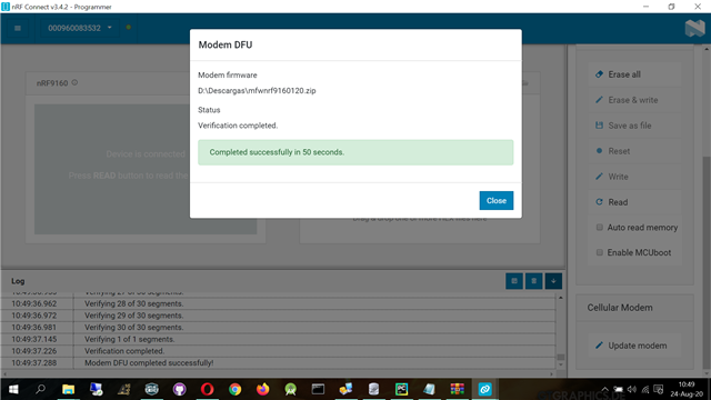

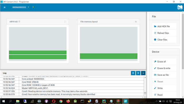

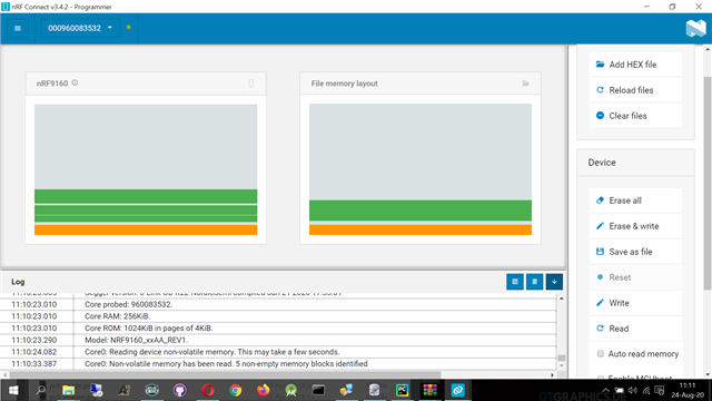

I have been trying to connect to 4G using iBasis and other vendor's SIM card but have not been successful.
I have the nrf9160 DK two years ago and have been sparsely trying to get it up and running for some time. I remember that when I began testing it (a bit over two years ago) the board connected to the 4G network but for some time now it doesnt.
I found this tutorial online: https://jimmywongiot.com/2019/05/09/quick-overview-to-run-sample-example-on-nrf9160-dk-board-with-nrf-cloud/
It states that I may have deleted a secret key that enables the device I am using to connect to the network. Would that be it? If so, how do I recover my device?

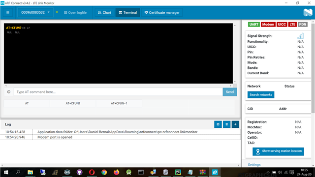

If that is not the issue, then I need some help to get the device to connect to the network (It cant even find any operators using AT+COPS? )
