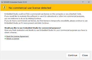

Greetings,
I just installed v5.10 of SES, and don't see the offer to obtain a Nordic license:
Bob
Greetings,
Bob
Hi Bob.
You can get your free license from this link and add it in SES by going to Tools > License Manager.
If this does not work I would recommend using SES v4.52 instead, as I know that works with the free license.
Marte
