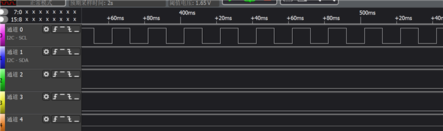

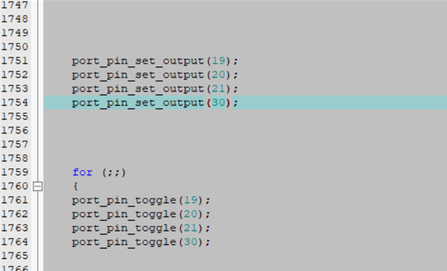

and i cut off the point of connect between u3 and nrf52840's qspi pin in pca10056.and i also cant measure the ware of spi .as the  description of nrf52840 ,p0.19 p0.20 p0.21 p0.22 is high speed gpio .so i dont know why the qspi‘s  io cant be spi pin.and i try to modify the the spi 's pin to other high speed pin,and it can work.so if the pin of qspi cant be spi's pin?
