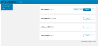

I am trying to install nRF Connect SDK v1.3.0 using nRF Connect v3.4.2 - ToolChain Manager using nRF Connect for Desktop(nrfconnectsetup342ia32.exe).
It just installs folder ncs\v1.3.0\toolchain, containing embedded studio and compiler. not syncing any other fodlers at ncs\v1.3.0\  such as  zephyr, nrf, bootloader.
After installation I couldnot see Open IDE button next to nRF Connect SDK v1.3.0
it is not even alerting with any failed installation message.

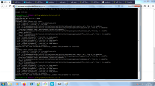

When i click open bash ,  i got message
NCS repositories are not yet cloned here. To do so run the following command:
ncsmgr init-ncs
when I ran command ncsmgr init-ncs, i got below error mentioned in the screen shot
nRF Connect SDK v1.2.0 using nRF Connect v3.4.2 - ToolChain Manager
But I could install nRF Connect SDK v1.2.0 using nRF Connect v3.4.2
After installation I could see Open IDE button next to nRF Connect SDK v1.2.0
          Need to try sample application building.
Please suggest on how to resolve this issue so that i can install nRF Connect SDK v1.3.0
    ncsmgr init-ncs

  • Hi Oyvind, I have the same problem.
    Using nRF Connnect V3.4.2, and Toolchain Manager v0.7.1
    I install SDK v1.3.0 but don't get the Open IDE button.
    In my install directory I only have .west nrf toolchain directories.

  • I haved installed SDK at  folder: D:\ProgramData\nordic\ncs
        D:\ProgramData\nordic\ncs\v1.3.0   <-- SDK 1.3.0 : Not successful
        D:\ProgramData\nordic\ncs\v1.2.0   <-- SDK 1.2.0 : successful
    Toolchain manager used -  Version : 0.7.1
    Toolchain manager installed at : C:\Users\chandra\.nrfconnect-apps\node_modules\pc-nrfconnect-toolchain-manager

    Can you please choose directory to e.g. C:\Nordic\NCS130\. Just remove the current "installed" version, and reinstall NCS v1.3.0 with changing directory to C:\<your folder>\NCS130.
    The important thing to test here is to use C:\, this is what I used and what worked for me.
    Thanks!
    -Øyvind
