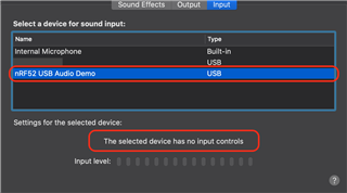

I'm attempting to control the microphone level from Windows 10 and Mac OS by configuring a Feature Unit.
The USB audio example demonstrates how to configure a feature unit to control the microphone mute.
I've modified the example code to add APP_USBD_AUDIO_FEATURE_UNIT_CONTROL_VOLUME and APP_USBD_AUDIO_FEATURE_UNIT_CONTROL_AUTO_GAIN.
If APP_USBD_AUDIO_FEATURE_UNIT_CONTROL_VOLUME is specified, Windows 10 reports a problem with the device and fails to load the driver.
If APP_USBD_AUDIO_FEATURE_UNIT_CONTROL_VOLUME is not specified, Windows 10 loads the driver and it's possible to control microphone mute and AGC.

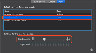

I'm comparing the audio example with a commercial product that controls the microphone level. The descriptors are the same, but the modified example doesn't work.
On Windows and MacOS, settings are available for adjusting the microphone level for the commercial product whereas the modified example however does not. I've attached screenshots of the differences between a commercial product and the modified example code on Mac OS.
Am I missing anything which would make it possible to adjust microphone level from the host OS?

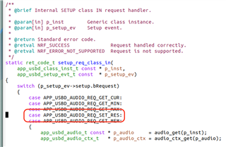

  • I believe I have found the solution.
    In the function setup_req_class_in in the file <nRF SDK>/components/libraries/usbd/class/audio/app_usbd_audio.c the case statement contains APP_USBD_AUDIO_REQ_SET_RES. In the context of the case statement this looks to be incorrect and should be APP_USBD_AUDIO_REQ_GET_RES.
    Making this change results in being able to set the microphone level on Windows 10 and Mac OS.
    I used WireShark to sniff USB traffic and noticed that host made the request (URB_CONTROL in) for CUR, MIN, MAX and RES. The example code responded to all except RES. Making the change above completes the request.
    JohnD.
