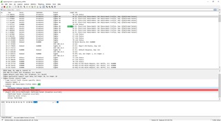

I'm trying to send some payload via ELECTRICAL_MEASUREMENT cluster.
The sending is realized in the similar way to the zigbee_light_switch example.
I'm sending data to the broadcast addr:
    zb_uint16_t addr = 0xFFFF;
    uint16_t measured_val = 0xABCD;
    NRF_LOG_INFO("Send el measurement command");
    ZB_CUSTOM_EL_MEASUREMENT_SEND_REQ(bufid,
                           addr,
                           ZB_APS_ADDR_MODE_16_ENDP_PRESENT,
                           HA_SMART_PLUG_ENDPOINT, //todo
                           ZB_AF_HA_PROFILE_ID,
                           ZB_ZCL_DISABLE_DEFAULT_RESPONSE,
                           NULL,
                           measured_val);
Where the macro is:
#define ZB_CUSTOM_EL_MEASUREMENT_SEND_REQ(                                                                                                    \
    buffer, addr, dst_addr_mode, dst_ep, ep, prof_id, def_resp, cb, measured_val)                                                             \
  zb_uint8_t* ptr = ZB_ZCL_START_PACKET_REQ(buffer)                                                                                           \
  ZB_ZCL_CONSTRUCT_SPECIFIC_COMMAND_REQ_FRAME_CONTROL(ptr, def_resp)                                                                          \
  ZB_ZCL_CONSTRUCT_COMMAND_HEADER_REQ(ptr, ZB_ZCL_GET_SEQ_NUM(), ZB_ZCL_CMD_ELECTRICAL_MEASUREMENT_GET_MEASUREMENT_PROFILE_RESPONSE_COMMAND); \
  ZB_ZCL_PACKET_PUT_DATA16_VAL(ptr, (measured_val));                                                                                          \
  ZB_ZCL_FINISH_PACKET(buffer, ptr)                                                                                                           \
  ZB_ZCL_SEND_COMMAND_SHORT(                                                                                                                  \
      buffer, addr, dst_addr_mode, dst_ep, ep, prof_id, ZB_ZCL_CLUSTER_ID_ELECTRICAL_MEASUREMENT, cb);                                        \
After that I'm trying to find those data in the sniffer.
Cluster ID is correct, Cmd ID is also correct and the measured_val (0xABCD) is visible.
Unfortunatelly the packet seems to be malformed. Any idea what am I doing wrong and how to fix it ?

  • Thank You, where can I find the ZB_ZCL_ELECTRICAL_MEASUREMENT_SEND_GET_MEASUREMENT_PROFILE_INFO_RESP macro ? It seems not to be available in the sdk files ?
  • Thanks a lot. I am doing something wrong for sure Slight smile. In the ZB_ZCL_ELECTRICAL_MEASUREMENT_SEND_GET_MEASUREMENT_PROFILE_INFO_RESP  there is no place for the measured value. So in my understanding I should do the following:
    1. Update the measured value "internally" by calling the ZB_ZCL_SET_ATTRIBUTE.
    2. Gateway should send me request with proper ID to get those measured data.
    3. The ZB stack will send the response automatically in the background with updated (in I-st step) parameters.
    Please correct me if I am wrong.
    BR,
    Jakub
  • That's correct!
    In Zigbee the sensor data is stored as an attribute value. The other device may:
    - Query for the current value via the Read Attribute Request.
    - Subscribe to the attribute value changes via binding & configuring the reporting.
    There is a CLI example inside the SDK that is capable of doing both things.The sequence of commands, required to test the reporting can be found here:
    https://infocenter.nordicsemi.com/topic/sdk_tz_v4.1.0/zigbee_multi_sensor_example.html?cp=7_3_3_8_5_3_1#zigbee_multi_sensor_example_test
    The command that you were asking should be sent in response to the Get Measurement Profile Info command.
