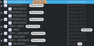

    The SDK version is 16.0.0
    I'm unsure how to determine the IC revision, I think below information is relevant.
    To be clear, my end goal is to be able to enumerate the device as USB CDC ACM serial port after being woken from system off mode via GPIO with the USB cable plugged in.
