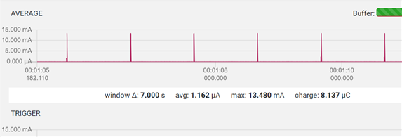

  • Hi Samya,
    I used PCA100040  DK and I just disabled NRF_LOG_ENABLED in the sdk_config.h and commented out uart_init() in the file you provided and i get the current consumption like below
    This confirms that the spike you are seeing is from the UART or maybe logs.

  • Yes I also disabled NRG_LOG_ENABLED in the sdk_config.h but I'm sitll getting 150mA when uart_init() is commented or 4mA when uart_init() is not commented. I've testing using both the oscilloscope and multimeter and both results are the same. Is it okay if I can have your code project where you copied my code and let me compared? I'm wondering if I accidentally enabled any other drivers/libraries that might cause additional current spikes.
    Also, if you uncomment uart_init() do you get an average current consumption of about 400uA?
