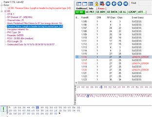

LE BB error LENGTH_ERROR while trying to send notifications.
We have a application where data transfers happen through a mechanism where the external client does a write-without-response to send in a command.  The response to the command is sent out in a series of notifications.  This normally all works correctly.

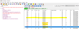

We are doing a test where where we connect  and configure the CCC and just before writing the command, we do a data length update to 27 bytes (previously 247).  The MTU is still at 247.  I write the response data using sd_ble_gatts_hvx which is 89 bytes.   The SD reports success.  This should be split into 4 LL layer packets of up to 27 bytes.  Instead we get several packets that contain LENGTH_ERROR  (See trace screen shot).  The sodera is reporting "Length in header too big for packet type".
The notification never comes through and the SD never reports the BLE_GATTS_EVT_HVN_TX_COMPLETE event.  Ive checked that the ble_gatts_hvx_params_t structure and length variable stay in scope and are not being overwritten.
We are using SD S140 v6.1.1 and SDK 15.3

    Please do.
    The SoftDevice architecture is very mature at this point, and bugs of this nature are extremely rare, so I am pretty sure the issue will go away if you run the SoftDevice/Nordic link layer on both sides.
    Also, you could check which version of the open source link layer they are currently running. There might be a more updated version on the master branch of the Zephyr repository.
