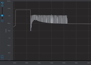

With this, when the NRF52832 goes to sleep, I am getting a sleep current of about 10uA.
Next, just added 4 more lines to disable and uninit the TWI:
    nrf_drv_twi_disable(&m_twi);
    nrf_drv_twi_uninit(&m_twi);
    *(volatile uint32_t *)0x40003FFC = 0;
    *(volatile uint32_t *)0x40003FFC;
    *(volatile uint32_t *)0x40003FFC = 1;

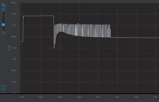

With TWI disable and uninit, when the NRF52832 goes to sleep, I am getting a sleep current of about 80uA. This does not make sense to me.

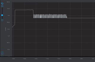

I also tried another scenario where I use TWI to communicate with the DS3231M (write to a register). If I do not disable and uninit TWI, I am getting a sleep current of 440uA
If I use TWI to communicate with the DS3231M (write to a register) and disable and uninit TWI, I am getting a sleep current of about 70uA.
Why is the sleep current at 10uA when I do not disable and uninit TWI? And why does the sleep current increase after I perform TWI communication and disable and uninit TWI? Is it not possible to perform TWI communication, disable and uninit TWI and have a sleep current of 10uA?

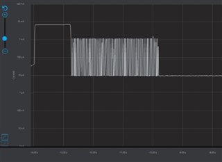

    I think the problem has something to do with the GPIO and button setup. I was using an external pull up resistor and an additional resistor capacitor pair for button debouncing. In my GPIOTE  I had disable pullups. This seemed to have caused the high current consumption (I am not too sure).
    Now I have removed the pull up resistor and also the resistor-capacitor pair. Just connecting the push button to ground on one side and the other side to GPIO pin on the NRF52832 and configuring  GPIOTE with pull up. I am now getting about 40uA with TWI communication and disable+uninit TWI. But I think it can be further improved. Because the DS3231M RTC module should only be consuming 5-10uA according to the datasheet.

    I managed to solve the problem. It was mostly a hardware issue with the DS3231M RTC chip. I just connect the primary supply to GND and the battery supply to VCC (3.3V) and the current reduced a lot.
    Disabling high accuracy mode for the GPIOTE also helps. Now I am able to achieve less than 10uA during sleep and wake up with GPIOTE pin interrupt.
