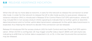

    Since the modem cannot run the GPS and LTE concurrently, it needs to switch between either of the "modes" or that you run the GPS when the LTE modem is in PSM mode or between the eDRX intervals when the LTE modem is in RRC IDLE mode. (see figure 1)
    To do the latter it is important to know that the network supports these features and that the SIM card in the device is approved by the network to use these features. (This can easily be tested by e.g. requesting some PSM interval from the network by AT commands and see if the network actually grants it, e.g. iBasis SIMs are not granted these features in all networks.)
    However, there is something called "RRC inactivity timer" which is the time the network requires the device to stay in RRC Connected mode before going into RRC IDLE or PSM mode. This is decided by the network you are on, some networks can have this timer set to 1minute and other 6 seconds, and this has a impact on power consumption and using the GPS in eDRX intervals in "RRC IDLE mode" or in "PSM mode".
    The purpose of the "RRC inactivity timer" is to avoid having to set up a new RRC connection immediately if there is a pending ACK or more data to be received from the network. This is decided by the network, and cannot be requested by the User Equipment.
    Note: For NB-IoT you can actually avoid that the device is stuck in this "RRC inactivity timer" by using "Release Assistance Indication" (RAI) feature. (described in figure 2)

    The problem with sending every 3 seconds is mainly this RRC inactivity time that prevents the GPS from running.
    Therefore, I think the best option to be able to achieve this would be to use NB-IoT and it RAI functionality (RAI is not yet supported on LTE-M in the mfw):
    (ref)
    This functionality can be enabled with the AT command AT%XRAI.
    Then you could switch fast between RRC Connected (sending the data) and RRC IDLE in eDRX interval.
