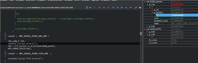

overrun error when receiving data from UARTE
I have problem with using nrf_serial.h, I am receiving data from Ublox GPS, baud rate = 9600, no flow control as we dont have enough IO pins.
Device is nrf52840 with SDK 16.0. I am using SERIAL_MODE_DMA, SERIAL_BUFF_RX_SIZE = 128, SERIAL_FIFO_RX_SIZE = 4096.
I am constantly getting NRF_SERIAL_EVENT_DRV_ERR events (overrun) even if fifo is empty (see picture below). If i get NRF_SERIAL_EVENT_RX_DATA event I set a flag and call nrf_serial_read in task as i dont want to spend too much time in IRQ.

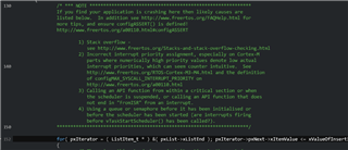

    I implemented libUARTE_async. Everything works fine until first buffer is filled, then my program goes in fault (see attached screenshot). Only thing I do in event handler on RX done is to print one random string, if I remove printf and do nothing in event handler I don't get a fault. I checked with debugger and buffer gets overfilled (my buffer is 200bytes long but there are 205 bytes written, so I suspect that causes a fault.
    Do you have any idea where problem could be?

  • Hi Luka
    Do you print the random string on the same interface that you receive data on?
    Are you able to share the event handler implementation from your code?
    Best regards
    Torbjørn
    No I print string on USB (similar to USB cdc acm example). Event handler is very simple, I would send received data to queue which is processed by task, but there is same problem if I just print random string.
