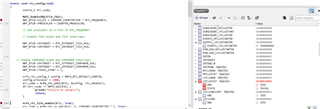

  • Hi Tobjorn,
    Yes, I had tried this basic RTC example and it worked for me. I was working on the other example as it was more of what I wanted when working with an interrupt.
    https://github.com/andenore/NordicSnippets/blob/master/examples/rtc/main.c
    The code works and I was trying to generate an interrupt on a compare event and that does not happen.
    I want to generate a compare event every 10 secs and so I set my CC[0] value to 327680. I want to trigger an interrupt as soon as the compare event is achieved and the interrupt should join back to the original program after 10 secs.
    When I run the code and view it in debug mode, I see that the counter as well as the compare register CC[0] resets to zero after the compare is achieved and the interrupt is not triggered. I assume that the code has to execute the interrupt handler RTC0_IRQHandler() after the compare event is done and the CC[0] value should not be reset to 0 automatically after the compare event.
    I have used the same code above and just changed the CC[0] value to 327680.
    Can you help me in identifying the issue here.
    Adeel.

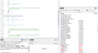

  • Hi Tobjorn,
    Yes. It could be and I am able to use the k_timers for generating timer interrupts after a certain defined time interval. But I also wanted to generate interrupts through an interrupt handler function that caters to the interrupts instantly through a handler.
    I tried it in the example mentioned above to try and enable an interrupt through NVIC_EnableIRQ (RTC0_IRQn). As per my understanding , this enabling of the interrupt should transfer the program to its handler function : void RTC0_IRQHandler(void) wherein I have a certain task written inside the handler function.
    Is there another example with the interrupt handler functions wherein I could check its functionality. I am basically trying to work on high priority interrupts.
    Adeel.
  • Hi Adeel
    The NVIC API is not supported in Zephyr.
    To enable an interrupt you have to do the following (using the RTC1 interrupt as an example):
    IRQ_DIRECT_CONNECT(RTC1_IRQn, 0, RTC1_IRQHandler, 0);
    irq_enable(RTC1_IRQn);
    Best regards
    Torbjørn
