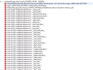

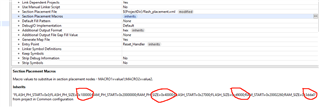

When using SDK5 From 52840 change to 52833 ,There are some errors,as below:
1.Output/Release/Exe/ble_app_hids_mouse_pca10056_s140.elf section `.init' will not fit in region `UNPLACED_SECTIONS'
2.region `UNPLACED_SECTIONS' overflowed by 56182 bytes
and more errors.............
en,Under SDK 16.0
  • Hi
     Are you still struggling with the RAM and Flash memory sizes, or are you having problems with something else now? Have you tried enabling debugging (set DEBUG in preprocessor definitions in your project options) to see what error is returning in the debug log? The information you have provided here is not very helpful for narrowing down what might be the issue here.
