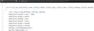

1. Does this mean that the nordic example here is wrong, and that line 54 should be time_struct.tm_mon = month - 1;  to account for the indexing difference?
2. My understanding is that mktime() should convert a datetime given in local time to unix time based in UTC. However, when I call mktime() with code almost exactly like the above + the corrections you suggested, the value is always 4h early. My timezone is 4 hours behind UTC. I printed using current_time_print() to verify that the local time coming from the phone into the BLE device is correct, so my suspicion is that mktime() is not actually taking into account the local time / instead is treating the local time as if it were UTC. Can you give insight into this structure:

    As far as I can tell, mktime() assumes your input is in local time and should take your timezone into account. For example, it is evident from this post on Stackoverflow that in the default C implementation, it should not be possible to interpret the input to mktime() as being from UTC (i.e., strip it of its timezone info) if timezone info is included.
    If you check this nordic sample function here, you can see that it doesn't take timezone into account; by separating out all the hour, min, etc. variables, the timezone info gets stripped. Ok fine, I can rewrite it to put timezone info back. But in order to rewrite it, I need to know how nordic encodes timezone info when a timestamp comes in over CTS.--> Question 1: where is timezone info encoded in the this structure?

    I think that some of the confusion here is that for the Current Time Service (CTS), timezone information is part of an optional characteristic that is not implemented by our CTS example. As such, any time received over CTS is of unknown time zone.
    mktime, on the other hand, do handle time zones.
    From what I understand, our libraries assume that the time zones of both the local and the external device are in UTC, for the purpose of storing time data and/or converting using e.g. mktime, as the "real" time zone is not known. As long as both the local and the external device operates in the same time zone, this should lead to consistent time tracking.
    Answer to Question 1: I do not find traces of time zone handling in that structure, nor in other related libraries.
    Answer to Question 2: This is specified in the Current Time Service specification from Bluetooth SIG, sections 3.1.2.1 through 3.1.2.4. The same specification also covers the (optional) Local Time Information Characteristic, which handles time zone data.
