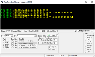

Hello everyone,
I'm trying to interface a NiceRF LN610 LoRaWAN chip to nRF52840 via UART. Initially, I tried communicating with the chip using CP2102 USB-to-TTL module and RealTerm in a Windows 10 PC and manually entering the commands there (after configuring the port properly). The LN610 chip responds and I get the required values to operate the LoRaWAN chip (see attached image, manual commands in green, chip response in yellow)
I then connected the LN610 TX & RX pins to nRF52840 GPIO pins P1.13 & P1.14, respectively, and then used the UART, SERIAL, and LIBUARTE peripheral examples in SDK16 to communicate with the LN610 chip but I failed to get any response from LN610 in each of the examples.

Would appreciate if someone could point me on what could possibly be wrong with my UART usage?
Thank you,
Carlos
