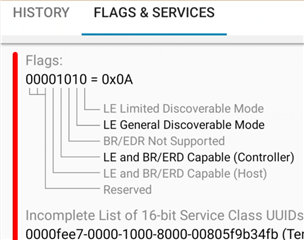

error in discovery_start()API,
slave information :blue tooth core 4.1
host information:blue tooth core 5.0
host examples is nRF5_SDK_15.3.0_59ac345\examples\ble_central\ble_app_uart_c,in this ecample,i modify the uuid same as slave.
problem:
in Service discovery ,when the code run  after  err_code = sd_ble_gattc_primary_services_discover(conn_handle, SRV_DISC_START_HANDLE, &(p_srv_being_discovered->srv_uuid));
it  return errcode(17),it means busy,then disconnectted, i do not no why,can you give me some advice. thank you.

  • my sdk version is SDK17.0,HW is nrf52832.
    I want to link with a Bluetooth Printer, this printer is a dual mode Bluetooth.
    I use the blue central example of  examples\ble_central\ble_app_uart_c,i have modified the uuid, now ,I can link to the device,but after running the Service discovery function(discovery_start()),it returns a errcode(0x11),it means  busy.
    it is running log under:

    I do not know why.
    it is the slave info I got by nrf connect tools.
  • Hard to say what is causing the SD to be busy. But it might be busy with some other event or waiting for something else as you are trying to connect. Could you try calling the service discovery after the device has successfully connected to the peripheral?
    Is changing the UUID the only change you have made to the example?
