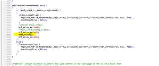

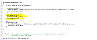

        During unprovison we have the function call mesh_stack_config_clear() to clear the mesh information, during the execution of this function we observe that the BLE chip is resetting because of which the unprovision might be not happening properly.
    Please let us know how we can handle it.
    Ram
  • Hi Robin,
       Additional to the above information please find the snippet where the BLE chip get reset when we try to close the app in which the provisioning is done.
    Ram

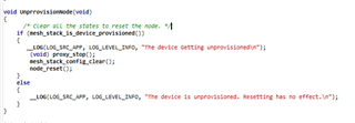

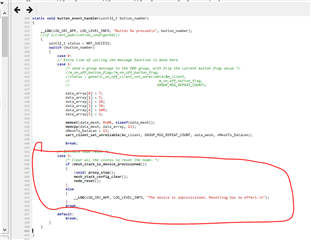

  • Hi Robin,
       As specified i  tried to use the function node_reset() to unprovison the device from the mesh network, But looks like the device is not getting unprovisioned from the network, In nrf Mesh APP it is showing in the provisioned list.
    Function Call:
    node_reset()
    Ram

    I suspect that you have reset the chip before you finished erasing the flash. Time to erase one page can take up to 89.7ms.
    Using a delay after calling mesh_stack_config_clear() may not be the best option.
    If you have a look at the apply_reset() function inside config_server.c you can find that we need to check for flash_manager_is_stable() before we forward the event to the application for a reset. And there we also check for flash stable before we trigger the reset.
    I'm not sure why you need to write your own UnprovisionMeshNode() function. Why wouldn't you use our already made function to handle node reset handle_node_reset() when receive CONFIG_OPCODE_NODE_RESET ?
    Which Mesh SDK are you using ? Have you tried to use our example for example lightswitch server and trigger a node reset from the app ? Which issue do you have when doing that ?

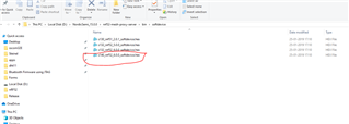

  • Hi Ramachandra,
    I don't recognize the "nrf52-mesh-proxy-server" folder. What's inside that folder ? Could you step in the bin\softdevices folder and take a screenshot?

    In our lightswitch server example we allow pressing button 4 to reset the node,  you can try to do the same on your firmware to check if it can reset the node (without sending mesh packet to reset) this way you maybe able to debug it easier. Note that to debug you need to clear the code optimization in the compiler.

      Please find the details below.
      The bin\softdevices contains the softdevice images. We are currently the BLE chipset nRF52840 and s140 softdevices ehile programming.

  • Hi Ram,
    It seems that you are using pretty old SDK, most likely SDK v2.2.0.
    I suggest you to move to latest SDK.

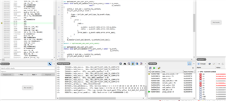

  • Hi Hung,
        We have observed the issue that the Exception is getting generated when the BLE APP which is connected to the BLE chip is is closed all of a sudden, It is generating the exception, Please find the snippet below for the call stack and the error
    Ram
