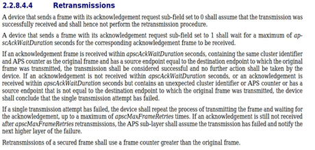

We have been working with a coordinator and a router device based on nRF52840 with nRF5_SDK_for_Thread_and_Zigbee_v4.0.0_dc7186b
Both devices are Zigbee 3.0 and implement Install Codes.
The router and end devices report periodically to the coordinator. After some time and power reconnections the sniffer starts to show that the same ZCL Report Attributes (same content, same Seq Id) is sent multiple times.
If the device is reset, there is no change. In fact, it seems to increment the number of packets with the same content.
Why is this generated? Is it a well known issue?
