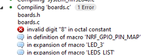

I use App_Hid_mouse example.When I change IO,Error came out.

Could you verify for me that the unmodified app_hid_mouse example from the SDK is working as intended?
Which SDK version and what hardwardware are you using?
Please elaborate on what changes you have made to the app_hid_mouse example prior to this error occurring. It looks to me as if you have changed something in the board configuration, but with the sparse information given it is hard to say anything certain.
code:
This is just the compiler error, and without any context it does not provide me with much to go after.
You should see where this error is generated, which function is being passed the '8' object, and what is the '8' object?

When I reedit the project,But there was no error again!
But I was amazing with another error:
when changed the Led port to P008 or P009,that error would come out.
I do not understand what you mean, but it seems that your initial problem was solved - which I am happy to hear!
For future reference, it will be much easier for us to help you in the forum if you provide more accurate / detailed information about your issue.
Good luck with your development!
Karl

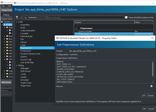

Could you make sure DEBUG is defined in your preprocessor defines?
How to check this is shown in the included picture:
With DEBUG defines you should be able to see the exact error code that was generated.
