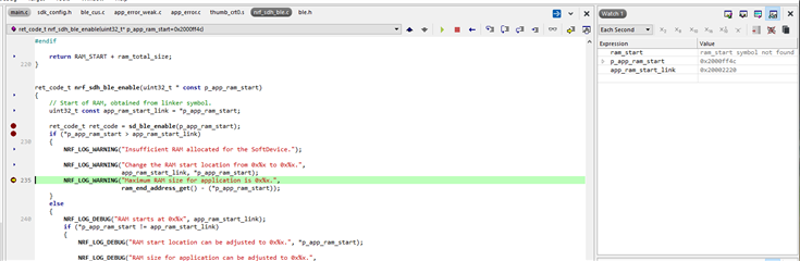

I traced the error to this function.
It enters the if statement indicating that there wasn't enough RAM allocated to the softdevice. It then indicates what to change the values to in order for it to be sufficient. Those values are shown in the image above as watches.
I set the RAM_START to the suggested value as is suggested in other blog posts. But it does not change this problem unfortunately. I have been loading the softdevice using nRFgoStudio, by selecting the hex file I downloaded for softdevice s132nrf52701.

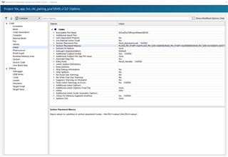

    When I go to look for the ram start and size I have been looking under the Common configuration > Code > Linker > Section Placement Macros. See below for how that looks on my screen.
    When I expand this field it shows the following:
    Is that what you were asking for?
  • this is the correct way of setting the ram start and size yes.

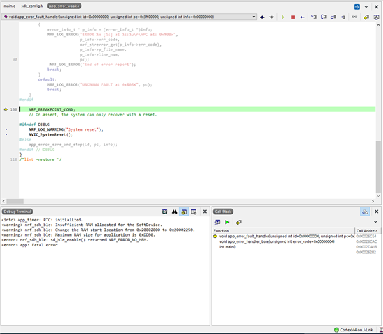

    I just notice it seems you are not using debug terminal, but instead you have set breakpoints in the assert handler. If you instead change the following in sdk_config.h:
    NRF_LOG_BACKEND_RTT_ENABLED 1
    NRF_LOG_BACKEND_UART_ENABLED 0
    NRF_FPRINTF_FLAG_AUTOMATIC_CR_ON_LF_ENABLED 0
    Then you should get the information you want in the debug terminal directly, as shown below:
    I am using the same SES version as you v4.52c, there are not errors with me unless I on purpose change the ram start and size to something like:
    RAM_START=0x20002000
    RAM_SIZE=0xE000
    Then it will assert and output as shown in the debug terminal window.
  • This helped! It seems that the Error was resolved by changing it to the values listed in the Debug Terminal rather than trying to use the ones I was seeing before. I'm not sure why the values were different.
