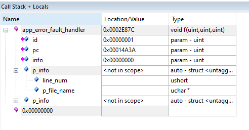

  • Hi
    I tried to run the program in debug whithout the breakpoint and it has stopped at line 100 of app_error_weak.c

    so after i have put a breakpoint on the line 57 to get the stack when the softdevice assert here :
    __WEAK void app_error_fault_handler(uint32_t id, uint32_t pc, uint32_t info)
    //breakpoint here{
    So the stack look like this when i have the sofdevice assert with the breakpoint:
    Can you please check sdk_config.h and look for a definition of NRF_FSTORAGE_SD_MAX_WRITE_SIZE. By default I think this is set to 4096 in most cases. Can you please try to set this to 1024 instead? this is just a backend setting, so your application logic doesn't need to think about this.
    Try that, and see if the assert still occurs.
    Edvin
