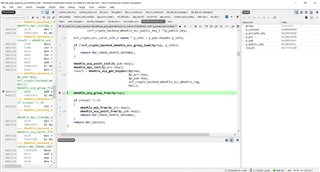

I am using nRF52840, SDK16 & SoftDevice140.
I am integrating pm_init()(Peer Manager) into my project and I am getting error 0xFFFFB180 from mbedtls_ecp_gen_keypair(). I looked out for the problem and find this thread which says there may be a problem of mbed libraries.
I am already using AES-ECB-256 encryption (mbedtls library) in my code. I don't think so but to be sure, can that be a cause of this error?
Kindly help me out!
    I do not immediately see the link. Do you have a piece of code you can upload that reproduces this on a DK?
  • I don't have any different code because I am ported my code to the design of our custom board. But for this problem, I have just copied the peer_manager_init() from ble_app_hrs example.
    Before adding that I had already added crypto libraries for another purpose and as mentioned earlier, I needed 256-bit encryption so instead of using CC310, I am using mbedtls library. So all the crypto libraries were already there to support peer_manager_init().
    Now when I run, I get the error 0xFFFFB180 in mbedtls_ecp_gen_keypair() (peer_manager_init --> pm_init --> sm_init --> nrf_ble_lesc_init --> nrf_ble_lesc_keypair_generate--> nrf_crypto_ecc_key_pair_generate --> nrf_crypto_backend_mbedtls_key_pair_generate --> mbedtls_ecp_gen_keypair)
    I have managed to reproduce this, and get memory corruption in mbed TLS using the default sdk_config.h memory manager configurations from the BLE peripheral examples, which do not use mbed TLS by default. Modifying the configuration like this fixed the issue (sdk_config.h snippet):
