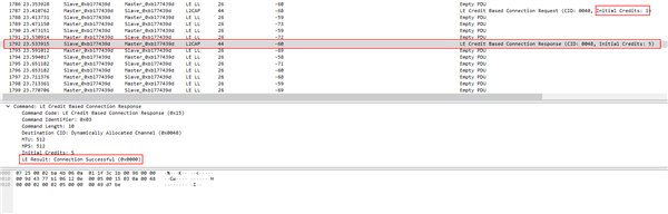

Unfortunately I face up with a limitation related to the initial credit.
In my application during LE Credit Based Connection Request (LE CBCR) the initial credit is set to 1. Is there any way to increase the number of the initial credits that are sent during the LE CBCR?
