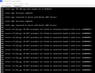

SD GATT procedure (%d) failed
Background: SDK 16.0.0, SoftDevice 7.0.1, 1 ble_central connected 6 ble_peripheral, Send an instruction to 6 ble_peripherals every 50 milliseconds, at the same time, the ble_peripheral returns the response data to the ble_central . An error will be reported after running for a period of time, the error code is as follows. The screenshot below is the error generated within 15 hours, 11times / 15 hours.
Operation flow chart
NRF_LOG_ERROR("SD GATT procedure (%d) failed on connection handle %d with error: 0x%08X.", p_req->type, conn_handle, err_code);
SD GATT procedure (1) failed on connection handle 0 with error: 0x00000013.
SD GATT procedure (1) failed on connection handle 3 with error: 0x00000013.
SD GATT procedure (1) failed on connection handle 1 with error: 0x00000013.
SD GATT procedure (1) failed on connection handle 5 with error: 0x00000013.
Error Code as below.

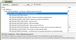

The length of a command or response is 11 bytes. sdk_config.h as below.

  • #define  NRF_ERROR_RESOURCES   (NRF_ERROR_BASE_NUM + 19)
    Not enough resources for operation.
    But I don't know what kind of resource shortage is。The smaller the time interval between sending data, the more likely this problem is。
    sender code:
    do
    ret_val = ble_nus_c_string_send(&m_ble_nus_c, tmp, len);
    if ( (ret_val != NRF_ERROR_INVALID_STATE) && (ret_val != NRF_ERROR_RESOURCES) )
       APP_ERROR_CHECK(ret_val);
    } while (ret_val == NRF_ERROR_RESOURCES);
  • thanks for your reply, According to your suggestion, I modified the code as follows and found no problem with 0x13,
    do
      err_code = ble_nus_data_send(&m_nus, data_array, &len, m_conn_handle);
        (err_code != NRF_SUCCESS) &&
        (err_code != NRF_ERROR_BUSY) &&
    } while (err_code == NRF_ERROR_BUSY || err_code == NRF_ERROR_RESOURCES);
