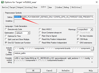

    Have you made sure to add DEBUG to your preprocessor definitions in order to get all debugging messages?
    Yes.
    I have added macro "DEBUG" in "Preprocesson Symbols".

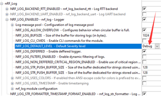

    I have set the debug level to "Debug" by nRF_Log module in file "sdk_config.h".

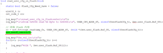

    read user infomation and check it, when first time read, the last page was erased to "FF", so when api check the read out value, will found the value is wrong. so need to save infomations to flash use "default" value.
    void read_user_cfg_in_flash(void)
        static bool Flash_Cfg_Need_Save = false;
        uint32_t i;
        log_msg("\r\nread_user_cfg_in_flash:enter\r\n");
        log_msg("\r\nfrom 0x%08X read %d Byte to 0x%08X\r\n", USER_CFG_ADDR_ST, sizeof(UserFlashCfg_t), Dev.user_flash.Buf_U8);
        // 读取 Flash 内容
        nrf_fstorage_read(&my_fs, USER_CFG_ADDR_ST, (void *)Dev.user_flash.Buf_U8, sizeof(UserFlashCfg_t));
        log_msg("the_val_is:\r\n");
        for(i=0; i<sizeof(UserFlashCfg_t); i++)
            log_msg("%02X ", Dev.user_flash.Buf_U8[i]);
        log_msg("\r\n");
        log_msg("record_cnt = %08X(%d)\r\n", Dev.user_flash.Pkg.record_cnt, Dev.user_flash.Pkg.record_cnt);
        log_msg("dev_id = %02X(%d)\r\n", Dev.user_flash.Pkg.dev_id, Dev.user_flash.Pkg.dev_id);
        log_msg("report_freq = %02X(%d)(%d)\r\n", Dev.user_flash.Pkg.report_freq, Dev.user_flash.Pkg.report_freq, (1 << (4 + Dev.user_flash.Pkg.report_freq)));
        log_msg("rf_ch = %02X(%d)(2.4%dGHz)\r\n", Dev.user_flash.Pkg.rf_ch, Dev.user_flash.Pkg.rf_ch, (Dev.user_flash.Pkg.rf_ch / 10));
        log_msg("name_id = %02X(%d)\r\n", Dev.user_flash.Pkg.name_id, Dev.user_flash.Pkg.name_id);
        log_msg("amplify = %02X(%d)(%d)\r\n", Dev.user_flash.Pkg.amplify, Dev.user_flash.Pkg.amplify, (Dev.user_flash.Pkg.amplify * 500));
        log_msg("CompassCali_t = xyz=(%02X %02X %02X)(%d %d %d)\r\n",
                Dev.user_flash.Pkg.compass_cali.x,
                Dev.user_flash.Pkg.compass_cali.y,
                Dev.user_flash.Pkg.compass_cali.z,
                Dev.user_flash.Pkg.compass_cali.z);
        log_msg("\r\n");
        // 检查 dev_id
        if(! Check_DevID(Dev.user_flash.Pkg.dev_id))
            Dev.user_flash.Pkg.dev_id = 0;
            Flash_Cfg_Need_Save = true;
        // 按需保存设备信息
        if(Flash_Cfg_Need_Save)
            log_msg("save_cfg\r\n");
            Dev.user_flash.Pkg.record_cnt += 1;
            user_cfg_write();

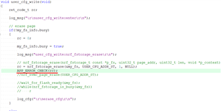

    void user_cfg_write(void)
        ret_code_t rc;
        log_msg("\r\nuser_cfg_write:enter\r\n");
        // erase page
        if(!my_fs_info.busy)
            rc = 0;
            my_fs_info.busy = true;
            log_msg("user_cfg_write:nrf_fstorage_erase\r\n");
            // nrf_fstorage_erase(nrf_fstorage_t const *p_fs, uint32_t page_addr, uint32_t len, void *p_context)
            rc = nrf_fstorage_erase(&my_fs, USER_CFG_ADDR_ST, 1, NULL);
            APP_ERROR_CHECK(rc);
            //nrf_nvmc_page_erase(USER_CFG_ADDR_ST);
            //wait_for_flash_ready(&my_fs);
            //while(nrf_fstorage_is_busy(&my_fs))
            log_cfg("\r\nerase_cfg\r\n");
        else
            log_cfg("\r\nerase_busy\r\n");
        log_msg("set_need_write_flag\r\n");
        // fill write parameter
        my_fs_info.need_write = true;
    in order to save user config infomation to flash, first, I need to erase the user flash area (i used the last page of flash)

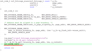

    nrf_fstorage_erase
    ret_code_t nrf_fstorage_erase(nrf_fstorage_t const * p_fs,
                                  uint32_t               page_addr,
                                  uint32_t               len,
                                  void                 * p_context)
        NRF_FSTORAGE_PARAM_CHECK(p_fs,        NRF_ERROR_NULL);
        NRF_FSTORAGE_PARAM_CHECK(p_fs->p_api, NRF_ERROR_INVALID_STATE);
        NRF_FSTORAGE_PARAM_CHECK(len,         NRF_ERROR_INVALID_LENGTH);
        /* Address must be aligned to a page boundary. */
        NRF_FSTORAGE_PARAM_CHECK(addr_is_page_aligned(p_fs, page_addr), NRF_ERROR_INVALID_ADDR);
            addr_is_within_bounds(p_fs, page_addr, (len * p_fs->p_flash_info->erase_unit)),
        log_msg("\r\nnrf_fstorage_erase:enter\r\n");
        log_msg("(p_fs->p_api)->erase\r\n");
        return (p_fs->p_api)->erase(p_fs, page_addr, len, p_context);

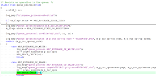

    queue_process
    in this function, maybe some error happend here: rc = erase_execute(m_p_cur_op);
    when the code enter here, there is no log_msg any more, and code can't run any more.
    if i don't save infomation to my user flash area, i can see the code run correctly by a led blink and other log message. so, error happend here. but the source code of "erase_execute" is unviewable.
    /* Execute an operation in the queue. */
    static void queue_process(void)
        uint32_t rc;
        log_msg("\r\nqueue_process:enter\r\n");
        if (m_flags.state == NRF_FSTORAGE_STATE_IDLE)
            log_msg("queue_process:queue_load_next\r\n");
            if (!queue_load_next())
                /* No more operations, nothing to do. */
                m_flags.queue_running = false;
                log_error("queue_process:queue_running_false\r\n");
                return;
        log_msg("queue_process:update_m_flags.state\r\n");
        m_flags.state = NRF_FSTORAGE_STATE_OP_EXECUTING;
        log_msg("queue_process:1 rc=%02X(%d)\r\n", rc, rc);
        log_msg("queue_process:switch (m_p_cur_op->op_code = %02X(%d))\r\n", m_p_cur_op->op_code, m_p_cur_op->op_code);
        switch (m_p_cur_op->op_code)
            case NRF_FSTORAGE_OP_WRITE:
                log_msg("queue_process:NRF_FSTORAGE_OP_WRITE\r\n");
                rc = write_execute(m_p_cur_op);
            case NRF_FSTORAGE_OP_ERASE:
                log_msg("queue_process:NRF_FSTORAGE_OP_ERASE\r\n");
                log_msg("queue_process:page=%08X(%d) progress=%08X(%d)\r\n", m_p_cur_op->erase.page, m_p_cur_op->erase.page, m_p_cur_op->erase.progress, m_p_cur_op->erase.progress);
             default:
                log_msg("queue_process:rc = NRF_ERROR_INTERNAL\r\n");
                rc = NRF_ERROR_INTERNAL;
        log_msg("queue_process:2 rc=%02X(%d)\r\n", rc, rc);

    my project is based on "nRF5_SDK_17.0.0_9d13099\examples\proprietary_rf\esb_prx\pca10040\blank\arm5_no_packs"
    I changed the file sdk_config.h

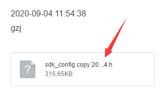

    the whole sdk_config.h is here:
    if you can't visit it, please give me an email to  [email protected]
    Looking forward to your replay!
  • Hi
    Please try adding some APP_ERROR_CHECK(err_code); to get some return values to your error codes, as the logging you're seeing is only "info" logging. You can check out this guide to see how you should implement this.
    Simon
  • Thanks for your replay!
    I added APP_ERROR_CHECK(rc):
    but still nothing get from log message.
    Did you checked my "sdk_config.h" file?  Have you got that file ?
  • I'd prefer if you could upload the sdk_config.h file as a .zip file if it is too large to upload by itself. I see that I neglected to add the link to the debugging guide I mentioned in my last reply. Sorry about that!
    https://devzone.nordicsemi.com/f/nordic-q-a/10729/my-device-is-freezing-and-restarting
    Simon
