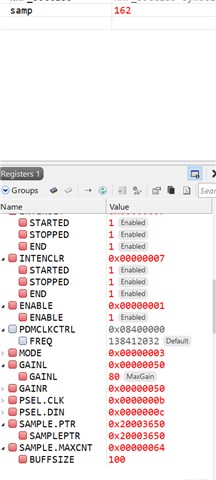

It seems like I'm loosing PCM audio data (decimated from PDM via PDM peripheral on nRF52832 interfacing ST mic) when transmitting the data onto UART.
I've interfaced an ST mic eval board (STEVAL-MIC006V1) to the nRF52 dev board on the PDM interface (SDK-15.2.0) . I'm attaching the code for showing my configuration and flow of capturing data and pushing it over UART, for your reference. I just want to dump 16KHz PCM output data from RAM to serial terminal so that I can read that data from terminal (with the help of a python script) and either log the raw byte values in a .csv file or generate  a wave file. I did many attempts in doing so but only got a little close to getting roughly correct data in one case (I checked by generating and playing back the .wav file, parts of it were the distorted version of my voice recording).
I think I'm loosing data on communication because when I increase the Baud rate and run a python script to count number of bytes received in 1 second, I get higher values with higher baud rate. Theoretically, if sampling rate is 16KHz and samples are 16 bit wide , I should get ~32000  bytes in 1 sec on the terminal but best I get is around 16000 bytes with very high baud rate.
Please go over my code and help me out with it.
Here, pressing button 2 starts the process of reading PDM data and converting to PCM and button 3 stops the process under bsp_event_handler(bsp_event_t event) in main.c
In nrfx_pdm_irq_handler(void) in nrfx_pdm.c, under the case nrf_pdm_event_check(NRF_PDM_EVENT_END), I am splitting the 16 bit uint16_t values into 2 8bit uint8_t integers and transmitting them over UART.
I've modified the uart_central example to incorporate pdm mic application. Please go through the files and let me know what is it that I'm doing wrong.

    above, samp value is 162 in 1 second and the Buffsize is 100. samp is incremented at every END event i.e everytime buffer of 100 samples (uint16_t) is filled samp is incremented by 1. Hence if after 1 second I have 162 increments of samp it means there are 162*100=16200 samples in one second, which is equal to PCM output sample frequency.
    How often do you see that these lines prints anything, and what do they print?
    For some reason it doesn't enter into the if condition only or it doesn't check the if condition only.
