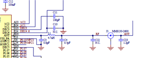

Is there a way to create a dual antenna PCB layout (SMA + PCB antenna) ?
  We have successfully created a PCB layout with a PCB antenna following the reference schematic provided by the nrf8001 datasheet. We tested and it is working fine. However we would like to add an option to the user to insert an antenna to increase the BLE range but still letting the PCB antenna there.
  Is this feasible, is there any dual antenna (SMA + PCB antenna) reference schematic so we could analyse and base our design on? Or should I just create a support ticket for Nordic technical support staff to help us out on this issue?
