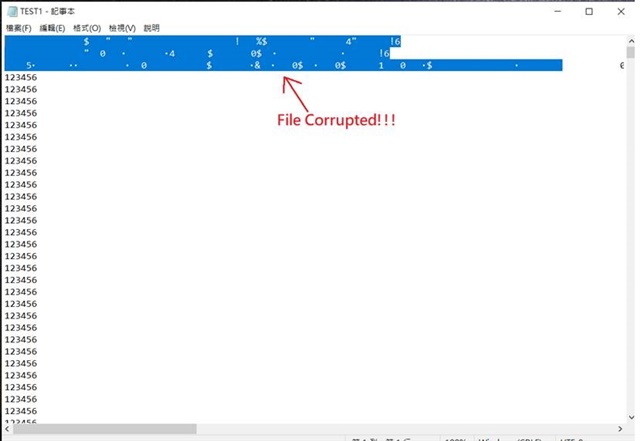

     We found USB MSC File Corruption issue on nRF52840 SDK. It is 100% repeatable.
     Below is the test method and  result:

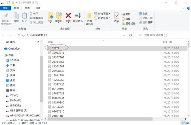

  4. Press Button 1 on the PCA10056 EVB. Test1.txt and totally 250 random files will be created automatically. Please refer to the attached debuglog.txt
  5. Connect USB and use notepad to open Test1.txt, found the file Test1.txt was Corrupted due to Random files creation.

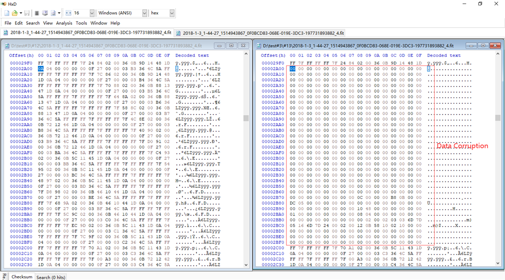

Test Result:
   More information:
  1. You can also download  the attached “usbd_msc_pca10056.hex”  file to your PCA10056 EVB for quick test.
  2. We have tested the most updated SDK.17.0, this issue still exist.
  3. We have searched the internet, and many people have reported this issue before since sdk 15.2 but still no any solution provided.

void create_test_file(void) {
    FRESULT ff_result = FR_OK;
    FIL file1;
    uint32_t num;
    char buf[] = "123456\r\n";
    ff_result = f_open(&file1, "test1.txt", FA_CREATE_ALWAYS | FA_WRITE);
	if (ff_result != FR_OK) {
		NRF_LOG_INFO("\r\n#1Unable to open file: %u", ff_result);
    for (uint32_t i = 0; i < 4096; i++) {
        f_write(&file1, buf, strlen(buf), &num);
    ff_result = f_close(&file1);
		NRF_LOG_INFO("\r\n#1Unable to close file: %u", ff_result);
	NRF_LOG_INFO("\r\n Test1.ext created Done");

    while (true)
        while (app_usbd_event_queue_process())
            /* Nothing to do */
        /* Process BSP key events flags.*/
        uint32_t events = nrf_atomic_u32_fetch_store(&m_key_events, 0);
        if (events & KEY_EV_RANDOM_FILE_MSK)
		    NRF_LOG_INFO("1. Format Disk.");
            fatfs_mkfs();
		    NRF_LOG_INFO("2. Create Test file.");
            create_test_file();
		    NRF_LOG_INFO("3. Create Random files.");
             for (uint32_t i = 0; i < 250; i++) {
               NRF_LOG_INFO("File create count(max 250): %d",i+1);
                 fatfs_file_create();
			 NRF_LOG_INFO("4. Created file list:");
			 fatfs_ls();
			 NRF_LOG_INFO("5. Connect to PC and open TEST1.txt to check if file corrupted or not.");

[00:00:00.000,000] <info> app:
Creating filesystem...
[00:00:00.000,000] <info> app: Mounting volume...
[00:00:00.000,000] <info> app: Done
[00:00:00.000,000] <info> app: 1. Format Disk.
[00:00:00.000,000] <info> app: 2. Create Test file.
[00:00:00.000,000] <info> app: 3. Create Random files.
[00:00:00.000,000] <info> app: File create count(max 250): 1
Creating random file: 1dcf9710.txt ...done
[00:00:00.000,000] <info> app: File create count(max 250): 2

[00:00:00.000,000] <info> app: 4. Created file list:
Listing directory: /
    32768  TEST1.TXT

Entries count: 252
[00:00:00.000,000] <info> app: 5. Connect to PC and open TEST1.txt to check if file corrupted or not.

  • Thanks.
    We also tried the attached main.c. It auto write log_entry to a file every 0.5sec.
    When data reord reach to about 256, the file corruption issue happens.
    Please see my attached main.c and the debug log.
        Repeat Sequence:
    1. Press Button 3  to format disk and reset the record_number to 0.
    2. Wait until the data record count  reach to  256.
    3. Connect PC to check the LOG_DATA.TXT.
    Platform: nRF52840
    HW board used: PCA10056
    SDK tested/used: SDK16.0 / SDK17.0
    Example used: sdk16_0\examples\peripheral\usbd_msc

    [07/09/20 - 19:59:21:175] [00:00:00.000,000] <info> app: USB power detected
    [07/09/20 - 19:59:21:181] [00:00:00.000,000] <info> app: Un-initializing disk 0 (QSPI)...
    [07/09/20 - 19:59:21:185] [00:00:00.000,000] <info> app: USB ready
    LOG_DATA.TXT
    Thank you for the detailed description and simple way to reproduce. I see the same on my side. A possible workaround is to disable writeback, by inserting 0 instead of NRF_BLOCK_DEV_QSPI_FLAG_CACHE_WRITEBACK on line 167. Does that work as a workaround for you?
  • Ah, yes. That makes sense. I will test and forward to the team working on this.
  • Has there been any update with the team working on this?
    This is still being actively looked into by the SDK team, but we do not have any conclusions yet.
  • Just keeping the thread alive, and seeing if there's been any progress at all
    Yes, there has been some progress. We have found a bug in the QSPI backend where it does not handle all possible states when configured in writeback mode. This can be fixed by modifying nrf_block_dev_qspi.c from SDK 17.0.2 like this (same approach should also be valid for older SDK version):
    diff --git a/components/libraries/block_dev/qspi/nrf_block_dev_qspi.c b/components/libraries/block_dev/qspi/nrf_block_dev_qspi.c
    index 6f1e0cd..29dc3cd 100644
    --- a/components/libraries/block_dev/qspi/nrf_block_dev_qspi.c
    +++ b/components/libraries/block_dev/qspi/nrf_block_dev_qspi.c
    @@ -1,4 +1,4 @@
    +/*$$$LICENCE_NORDIC_STANDARD<2016>$$$*/
      * Copyright (c) 2016 - 2020, Nordic Semiconductor ASA
      * All rights reserved.
    @@ -715,7 +715,9 @@ static ret_code_t block_dev_qspi_write_req(nrf_block_dev_t const * p_blk_dev,
         else
    -        if (p_work->writeback_mode)
    +        if (p_work->writeback_mode &&
    +            p_work->erase_unit_idx != BD_ERASE_UNIT_INVALID_ID &&
    +            p_work->erase_unit_dirty_blocks)
                 ret = block_dev_qspi_write_start(p_qspi_dev);
    We have not been able to reproduce the file corruption issue with this patch applied.
