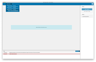

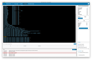

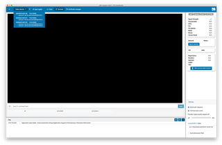

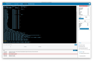

I am using an nRF9160 dev-kit and I am debigging some connectivity issues.
Unfortunately there is some random bahaviour on the Serial Interfaces, which are exposed to my Macbook.
Sometimes it is not possible to use the Trace Collector, sometimes it is working.
Port #2 is not selectable (it is the USB interface with 2 ports).
I have the impression it depends on the way, the USB ports are enumerated. I.e. sometimes it is working.
On Windows and Linux, I do not have the same problem.
But on Mac the "Auto Device/Port Filter" is not supported, I get individual ports.
I am attaching a few screenshots, which hopefully expain my problem.
And here are also some logfiles.

  • Hi Oliver,
    On MAC the serial ports are separately available, so there is no automatic logic to select the correct one.
    In other words the user needs to manually select the correct one.
    De-select the "Auto device/port filter":
    Select a COM port and then press restart on the DK to see the boot-up sequence.
    martin L.

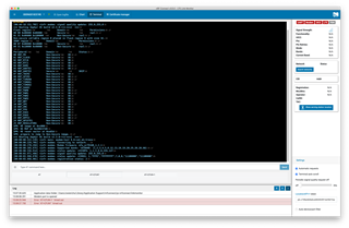

  • Hi Martin,
    I know, that the Auto device/port filter is not supported on Mac and I need to selact manually.
    But my problem is, that not all ports are coming up properly.
    I usually can connect only to 2 ports out of the 3, which I should get:
    1) the nRF9160 AT command interface
    2) the nRF52840 showing this message: NRF52840 board control statically configured. DK Uptime is 3080 seconds
    3) Trace Collector coming up randomly, but quite often not.
    regards,
    Oliver
  • Hi Oliver,
    Correct,
    #1 there are is one port from the console of the nrf9160 (at_client in your case),
    #2 one port for the nrf52 (just running the boardcontroller app) and
    #3 last port is used for modem tracing when thats enabled(CONFIG_BSD_LIBRARY_TRAACING=y)
    The last port should only be used with the Trace Collector app. (opening that port in LTE Link Monitor would not work properly).
    Do you have issues using the Console port from nRF9160 with LTE link monitor and the modem trace port connected to Trace Collector?
    Could you give more details if that is the issue? (5/6 screenshots are corrupted)

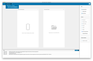

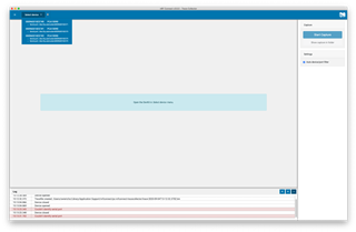

  • Hi Martin,
    the Console port of the nRF9160 is usually working fine.
    My problem is the 3rd port, which is numbered as port #2, i.e. the port for the Trace Collector App.
    When I try to open it, I get an error "Couldn't identify serial port"
    I have added another logfile and screenshot.
    Hopefully the PDF works.
    Oliver

    2020-09-07T13:33:09.633Z DEBUG App path: /Users/owierichs/.nrfconnect-apps/node_modules/pc-nrfconnect-tracecollector
    2020-09-07T13:33:09.633Z DEBUG nRFConnect 3.5.0 is supported by the app (^3.0.0)
    2020-09-07T13:33:09.633Z DEBUG nRFConnect path: /Applications/nRF Connect.app/Contents/Resources/app.asar
    2020-09-07T13:33:09.633Z DEBUG HomeDir: /Users/owierichs
    2020-09-07T13:33:09.633Z DEBUG TmpDir: /var/folders/d1/f1j8j__x7bx7dtwb3bcgwscm0000gn/T/
    2020-09-07T13:33:10.486Z VERBOSE Could not fetch serial number for serial port at /dev/tty.Bluetooth-Incoming-Port
    2020-09-07T13:33:55.655Z ERROR Couldn't identify serial port
    2020-09-07T13:34:59.412Z ERROR Couldn't identify serial port
  • Hi Oliver,
    Are you able to test the card on another platform to rule out any issues with the kit?
    It is very strange that it select "Could not fetch serial number for serial port at /dev/tty.Bluetooth-Incoming-Port"
    That is not a Jlink Serial port.
