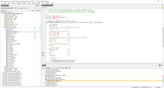

I am using this MBN52832DK and find out this nRF5_SDK_17.0.0_9d13099.
Trying to import into Segger Embedded Studio but rebuild come out error.
using the nrf52832_xxaa Internal.
Thank You

It should not be neccessarys to imprort IAR projects into SES as we include SES projects for all our SDK examples. Can you try to open the SES project located in \nRF5_SDK_17.0.0_9d13099\examples\ble_peripheral\ble_app_uart\pca10040\s112\ses\ instead?
Hello Vidar Berg
open the SES project located in \nRF5_SDK_17.0.0_9d13099\examples\ble_peripheral\ble_app_uart\pca10040\s112\ses\ble_app_uart_pca10040_s112.emProject. It can be open and build without error.
