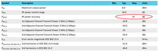

output power exceed +4dbm after matching circuit
when design the product, BLE output power set at +4dBm, and test the real output power with Spectrum Analyzer. when test at the MCU direct output pin the output power is about +3.5dBm, but when test after matching circuit, the output power is about +4.7dBm, the output power exceed the MCU output power, why this happens? Normally, the output power should  attenuation when after the matching circuit, i did not use a PA amplifier...
