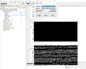

    I did not manage to replicate the assertion by transferring a large file from one board to the other. The screenshot below shows how my test was set up. And I used the original example without security from SDK 17.0.0.  Could you try the same?
