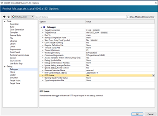

Hi.
I'm using ES.
RTT(Debug Terminal) on ES works fine. But sometimes I want to use J-link RTT viewer.
How can I turn off RTT on ES and then use J-link RTT viewer?
I hope you reply.
Hi.
I'm using ES.
I hope you reply.
Hi Roger,
You should be able to turn this OFF in settings:
