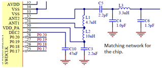

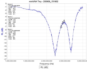

Measure the impedance:
PCB : thickness 1 t(1mn), 1/2oz, 2 layer
The antenna was removed and the VNA was connected between L3 and C6.
The impedance was about 100 ohms.
The part value is shown in the picture.
Question :
1. Should I connect the power and do TX mode or RX mode? (The result was the same whether or not the power was connected. about 100 ohms.)
2. L1 = balun, L2,C3 = ?, C5 = DC Blocking Capcitor, C4,L3,C6 = PI Network. What is l2 and c3?
3. It is currently about 100 ohms. Should the PI Network (C4, L3, C6) be adjusted to 50 ohms?
