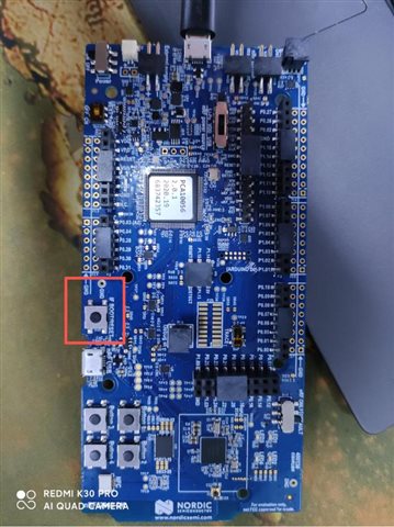

I was testing dfu mode with an nrf52840 dk and held down the IF BOOT/RESET button, then powered up and waited a few seconds before it went into bootloader mode and could not recover!
Please Advise.

Please try reinstalling the Interface MCU firmware. It can be downloaded here, and you can see how to reinstall/update it properly on this page in the Infocenter.
