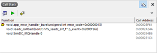

    I receive the following error code if I debug the ble_app_uart__saadc_timer_driven__scan_mode example:
    Unfortunaly, I am not able to find a error description for this error code.

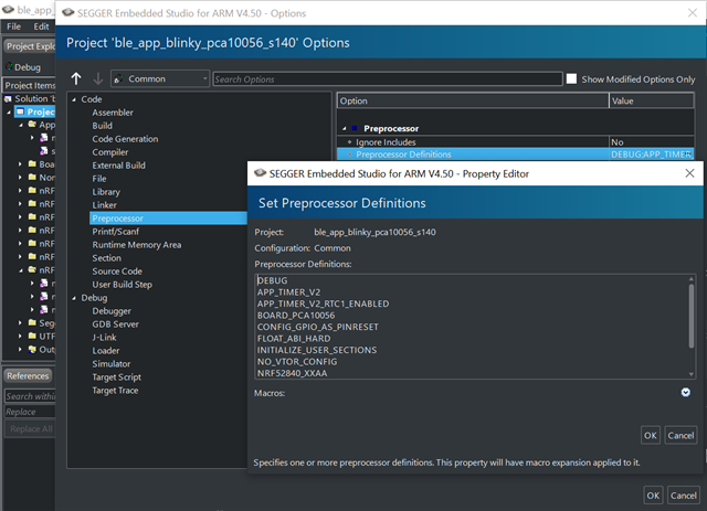

    Could you ensure that DEBUG is defined in your preprocessor defines?
    The included image shows how you can check this, or add DEBUG if it is missing.
    Please run the program again with DEBUG defined, to see the proper error message.

    3. Where can I find your included image for checking or adding DEBUG? How can I ensure that DEBUG is defined in my preprocessor defines?
    My apologies, it seems like my upload in the previous comment failed. I have updated my previous comment to contain the picture now.
    With DEBUG enabled the generated error will be output to the logging module. It will be very helpful to see this error code and where it is generated, to resolve your issue.

    thank you for your fast reply.
    I ran the program with the modified SAADC_SAMPLING_RATE (set to 1ms) again. This time with DEBUG defined. I receive the following error in the debug terminal:
    <info> app: Debug logging for UART over RTT started.
    <info> app: Connected
    <info> app: Data len is set to 0xF4(244)
    <error> app: ERROR 19 [NRF_ERROR_RESOURCES] at C:\SDK\SDKv17\nRF5_SDK_17.0.0_9d13099\examples\ble_peripheral\ble_app_uart__saadc_timer_driven__scan_mode_second\main.c:784
    PC at: 0x0002A417
    <error> app: End of error report
    It looks like that error gets produced by the ble_nus_data_send(...) function. Line 784 equals the line with the APP_ERROR_CHECK(...) in main.c:
            err_code = ble_nus_data_send(&m_nus, nus_string, &bytes_to_send, m_conn_handle);
            if ((err_code != NRF_ERROR_INVALID_STATE) && (err_code != NRF_ERROR_NOT_FOUND))
    Can you please explain to me, why the ble_nus_data_send(...) function, for sending data over BLE via NUS service, can´t handle the increased data rate?
    Do you have any suggestions how to solve this issue?
    Fantastic, this makes the issue a lot easier to resolve.
    Looking into the ble_nus_data_send function from the SDK/components/ble/ble_services/ble_nus/ble_nus.c file, we see that it returns the error code from sd_ble_gatts_hvx.
    Looking at the API Reference documentation for sd_ble_gatts_hvx we see that the NRF_ERROR_RESOURCES is generated when too many notifications are queued - i.e the frequency of calls to sd_ble_gatts_hvx is too high.
    This makes sense if you are trying to push a new notification every 1 ms, with the connection interval specified in the unmodified example ( 20 - 75 ms ).
    So, to resolve this issue, I would suggest either lowering your connection intreval to 7.5 ms ( if it is important that the SAADC readings are sent as fast as possible ), and averaging the measurements over >= 8 readings, to make sure that a new accurate reading is sent to the central every connection interval.
    Could you make these changes, and see if it resolves your issue?

    Basically, I save the SAADC readings for 7ms. In the next millisecond I transmit the actual SAADC readings and the saved SAADC readings of the last 7ms. On the central side I receive every 8ms 8 samples of each channel. This works for quite a few seconds or sometimes for one or two minutes.
    If it stopps after a few seconds I get the following error:
    <error> app: ERROR 4 [NRF_ERROR_NO_MEM] at C:\SDK\SDKv17\nRF5_SDK_17.0.0_9d13099\examples\ble_peripheral\ble_app_uart__saadc_timer_driven__scan_mode_optimized_third\main.c:237
    PC at: 0x0002A58D
    which is caused by the following function:
        err_code = app_uart_put(p_evt->params.rx_data.p_data[i])
    And sometimes I receive the following error:
    <error> app: ERROR 19 [NRF_ERROR_RESOURCES] at C:\SDK\SDKv17\nRF5_SDK_17.0.0_9d13099\examples\ble_peripheral\ble_app_uart__saadc_timer_driven__scan_mode_optimized_third\main.c:833
    PC at: 0x0002A4F1
    which is caused by the ble_nus_data_send(...) function.
